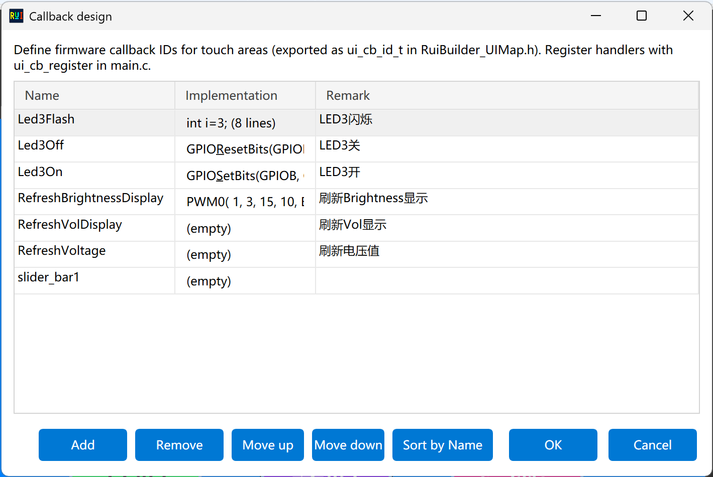

IDs and implementation code for Call callback; exported to TouchCallbacks.c.
Open Callback design. You define firmware callback IDs for “Call callback” on touch areas and buttons (ui_cb_id_t in RuiBuilder_UIMap.h). Firmware registers functions with ui_cb_register in main.c (follow the generated comments).
Three columns
| Column | Role |
| Name | Dropdown label on the property panel |
| Implementation | C snippet; click the cell to open the editor |
| Remark | For you |
Add / Delete / Up / Down / Auto arrange change the list. Order is the callback index — check controls after a shuffle.

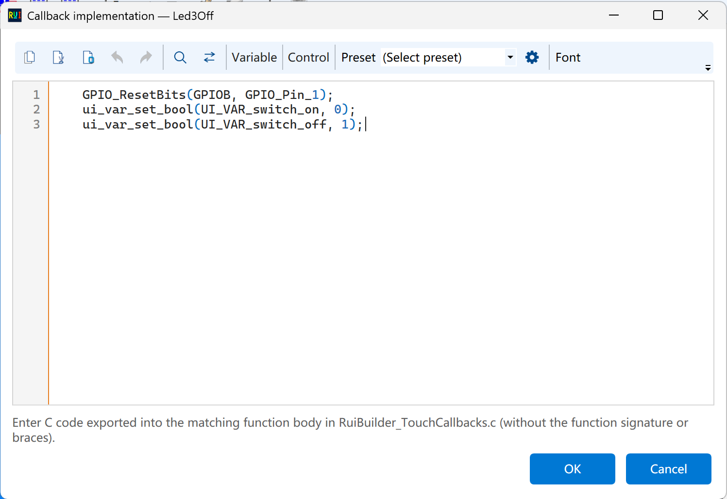

Implementation editor
Presets: delay, stop the touch loop, login check, set RTC, UART-send a variable, jump page, and more. Save presets on this PC or in the project. OK checks for missing semicolons.
- On re-export, an existing
RuiBuilder_TouchCallbacks.cappends by default and only syncs non-empty implementations. Overwrite choices: Export code. - Effect demo runs a subset (loops, jump, login). Peripherals belong on hardware.
